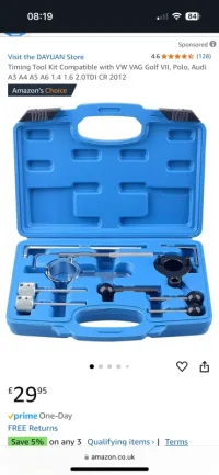

I bought a set of cheapish locking tools so plan is to try doing it “properly”.
In my head to simplify the instructions and videos I’ve watched. Let me know if it sounds like I’m missing something or doing something wrong?
1) Align engine into TDC position and lock all three pulleys with locking pins.
2) Lossen camshaft and fuel pump pulley to allow movement for tension.
3) Take tensioners, water pump off along with old belt
4) Put new belt and water pump on and tension correctly.
5) Torque everything to spec
6) Turn engine by hand twice and check everything again with locking pins, ignoring fact that fuel pulley might be slightly out.
