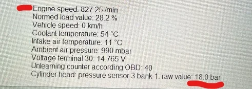

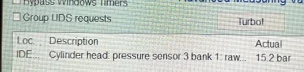

after looking at live data, we noticed IDE09330 are higher then the others. cyl.1-3 have "same" value, but cyl.4 runs higher number..

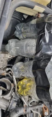

we suspect bad injector on cyl.4.. and we will do an return flow test on all 4 injectors..
