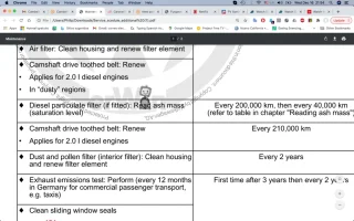

Think of it as getting paid about 500 quid to read the rest of the thread. @Loz even got in touch with the manufacturer of the belt, and VW service schedules from Germany, France, Belgium and Spain are quoted. The UK recommendation, which is the only outlier, comes from the private UK importer, VW UKCV, not the manufacturer of the van or the belt. The result is that money is being made by throwing out perfectly good parts in order to make some quick cash. VW UKCV has written to forum members who have questioned this, telling them that the basis for that recommendation. "is not available to be shared."Thanks, I think I got a few pages in and saw that 4yrs seemed about right. It was just a bit of a shock at the cost. Sat there smug thinking I’ve got 1 more free service, then pow!

You don't have to go all the way back. Start here:Thanks, I think I got a few pages in and saw that 4yrs seemed about right. It was just a bit of a shock at the cost. Sat there smug thinking I’ve got 1 more free service, then pow!

Thanks, read it all the way through now. I’ve got the van booked in for the service but think I’ll hold off a little while longer on the belt, still gonna get a price from the independent chaps thoughThink of it as getting paid about 500 quid to read the rest of the thread. @Loz even got in touch with the manufacturer of the belt, and VW service schedules from Germany, France, Belgium and Spain are quoted. The UK recommendation, which is the only outlier, comes from the private UK importer, VW UKCV, not the manufacturer of the van or the belt. The result is that money is being made by throwing out perfectly good parts in order to make some quick cash. VW UKCV has written to forum members who have questioned this, telling them that the basis for that recommendation. "is not available to be shared."
