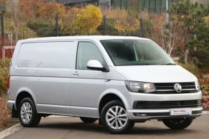

Once the decision had been made I found a T6 in the VW dealers in Llandudno Junctiom went to see it and bought it, she is a September 2015 102PS Highline with a Euro 6 engine
