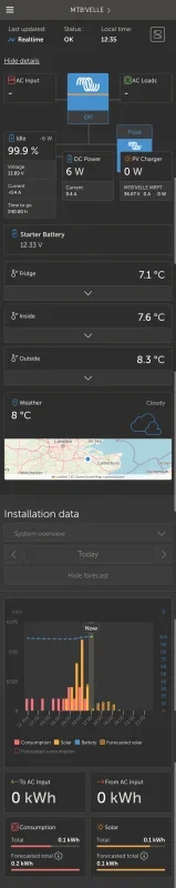

I just really like the screen and the information it has. Do I need it, NO!. Do I now want it, YES!
The screen is so handy when you just need to check charge status or solar power or something and even though my phone and the VRM app is literally 4 taps away, it's nice to have a screen in the van.
Of course without VRM (and the Cerbo GX) you'd need to connect via Bluetooth via the app, only within a few metres... Which is just not as easy!!
