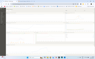

I'm a sucker for data, stats, graphs and spreadsheets.I just really like the screen and the information it has. Do I need it, NO!. Do I now want it, YES!

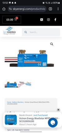

Paul, I have a Fogstar too so do I need this 'shunt'? Possible link to one if so?I have a fogstar 230Ah so need the shunt for the SOC. No direct input to the Cerbo like the Roamer smart4.
Which is the link cable please Matt? Is that the VE cable? I have two of those so farView attachment 278581

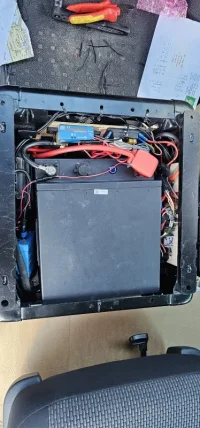

This is the one I added to my Fogstar Chris. Like Paul says just remember to add the link cable. This needs a double ended male as its socket to socket on the Cerbo. Also monitors my starter battery voltage.
