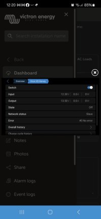

Is this the AMT trickle charging my starter battery?View attachment 280304
I don’t have a router in the van but do have lots of expensive wee blue boxesAll your victron devices will be drawing power, as will the router etc.
Check the input voltage (by way of testing you!) Mine here is being propped up by the Ablemail to keep it around 12.3v. If you've recently driven it the voltage should be higher than 12.3v, Ablemail will be dozing!I seem to have 11w going out from somewhere and I’ve everything switched off.

Charge levels, no - voltage, yes - so long as you're got the shunt aux connection going to the starter battery.Can you view how much charge the starter battery has on the Cerbo ?

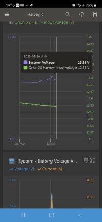

I like that tooYeah I've got one set up too, I also have mine on my main vrm screen
Let me refresh my memory! Bear with...I like that
How’d you do it Wayne?
Does this help?! Advanced, then edit widget, change the y axis, LB and SB are easier cos you can have the same 11 to 15v axis for both.Let me refresh my memory! Bear with...
Have a fiddle, you can always reset it!Does this help?! Advanced, then edit widget, change the y axis, LB and SB are easier cos you can have the same 11 to 15v axis for both.
You can have 4 different graphs all with their own axis, @TallPaul_S will show us one now!!
