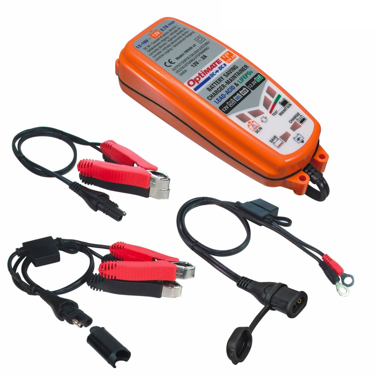

A further note that I came across the DC-DC battery maintainer from a reasonably well known brand. The charge rate is only 2A but that might still be useful.
