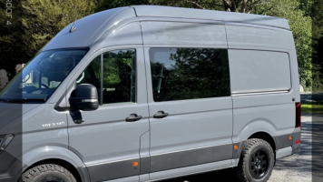

Hi, I found that one yesterday and it looks nice and fits well but it is £9k.
Skyline do one but it’s on straps which I don’t really like but it’s 4k
Was looking at this before we decided to get a Grand California, says it has an Austop pop top fitted, though Austop don’t have a Crafter specific pop top??
There was a conversion a while back in VWT magazine that used a normal skyline roof but had a mounting frame made by Rusty Lee. Looking at the one @bullracing posted a shortcut to it uses a bespoke mounting frame as well. I think part of the problem is that although you can use a t5/t6 roof itself the crafter roof is obviously wider than either of the other/s and there is virtually no support where the standard frame sits so could lead to the roof compressing over a period I& time without a bespoke support frame in addition to the frame it usually comes with. If your on Fb there is a crafter/man group that may give some alternative answers as a few on there have done it.

I had a good look at them and skyline do a roof especially for the crafter at 5k ish sprayed but after talking to the gentleman about the proper crafter roof that when fitted looks like a factory fit but 9k what has mad me decide to go for that one is that it is designed to take a standard small double mattress so we can put a nice memory foam one in so it will be like home from home .
