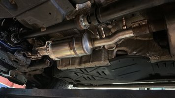

That would be an understatement......anything within a meter gets a dusting. Its new everything hence why I am looking at the injectors. New EGR New DPF New Turbo.IMG_4318.jpeg
And we wonder why these engines are problematic. ?????

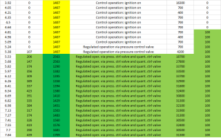

@mmi here is the VCDS file of a start with your common parameters. How can I be sure the ECU is sending a signal to the injectors?
For injector activation check that "Loc. IDE00352 Main injection: duration of activation" is varying from a sample to sample (in green below). On this engine the value doesn't reset to zero but "remembers" the last active value - yes, strange.
Thus, the injectors are commanded to fire by ECU.
All seems to be as expected - good: cranking, fuel pressure regulation, fuel pressure, lift pump activation.
As well as in 2nd cranking

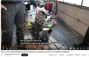

While the engine is out consider adding a oil cooler as I could easily get the oil temp to 130degrees and now with the wagner tuning oil cooler it hovers around 100-110 even when getting a thrashing. If you watch the redhead youtube videos they are of the opinion that the CXEB/CXEC has rubbish heat management which is why they are tending to get into a death spiral of burning oil at Turbo going into EGR intake blocking the DPF and causing all the problems that keeps this forum active. (if you dont speak germain the cc buton will translate for you.)

Watch that video from 4:20 onwards. They do not like the idea of tuning on a 204 ABT in this instance.
Yes. I saw that.
The dark side development guys also wasn't keen on tuning the 180ps. Or the 204..... But the 199 seemed to dyno well from stock.
