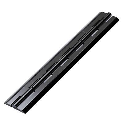

@DXX - Where did you buy the hinges from. I have Van X speaker cover on order and I might try and hinge the unit.
Bought Feb 2018, there maybe cheaper available and they come in different finishes. One hinge is too short for the full width.
