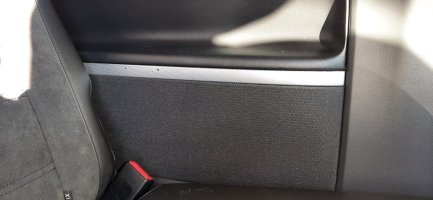

hello all , could anyone direct me to were i could purchase a passenger rear trim in the comfort dash colour structural? as i have one that is damaged. or maybe a supplier of the wrap material itself?
its for the rear panel over the wheel arch.. thanks
Do you have a pic of it?
I very much doubt you’ll find a wrap to match as that looks textured. Try Vw or TPS for one.
From what I can find. The colour is called structural. It doesn't seem to be textured.
I'd be surprised if you can buy just the decorative strip, vw will probably want to sell you the whole panel. I hope for your sake I'm proved wrong though.
been doing some digging and i think a similar if not the same pattern would be a silver carbon effect, now i cant make my mind up to weather they have been Dipped or Wraped
