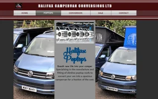

looks like we are getting somewhere. . . after getting no reply from VANMAX
we done some searching and come across this. - Which Pop-Top?
saying that VANMAX have shut down.
but @Bigsidavies come to the rescue with:
"Vanmax are now supplied by Halifax Camoer conversions. Just not naming them Vanmax at the moment from what I can work out on social media.
They used to be the main installer of the Vanmax roof prior to Vanmax stopping production of the VW roof.
Iain no longer does Vanmax for VW. I know that Halifax Camper Conversions supplies and fits the Vanmax roof but they don’t call it van max. But they were the main fitter of Vanmax roofs when Iain manufactured them.
A company had bought the van max brand but has done nothing with it, so I’m not sure how that aligns with Halifax Campers."
im happy with the non tubby look of the roof. .
so we contacted them for a rough price. . .
the following day they come back with:
"Hi there price for a swb slimline poptop roof is £4000 and colour coding is £500 , for a bifold bed price is £450
Price includes slimline poptop roof with a scenic canvas fully retrimmed to choice of carpet lining with led lights fitted, yes of course we can fit the kitchen and bed for you we would have to discuss what exactly need doing before we can price this up like fridge hob and sink, gas and all electrics etc
Are you local to us as if so you could call in so we can show you the roofs and have a chat about your requirements thankyou
M Carney"
looks like we are back on again. . . .

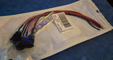

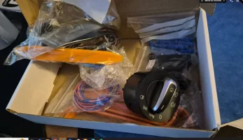

i got some more goodies for the Bus - from Travelin-Lite this time,
Auto Light switch,
wire taps,
MFSW wires,
new Brighter footwell kit (OEM light units)
and a few Mini ON/OFF switches from Amazon.
M Carney"

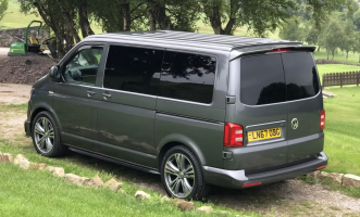

and when colour coded and fitted should look like this similar van to ours. . .
View attachment 276688View attachment 276689View attachment 276690

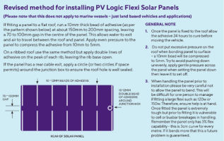

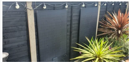

Solar Panel. . . 180W (24.0v VOC, 9.22A ISC) Black, Mono, rear junction.
I've asked the pop-top installer to fit the panel. . .
I've included the install guide in the panel box,
and I've highlighted the install notes about FILLING IN THE ROOF RIDGES, to create a smooth surface (for equal thermal expansion across the panel)
and I've highlighted the bonding methods,
but really I'm in there hands, ill voice my concerns about the fitting. (but they will be, weve fitted loads of panels and never had one go wrong) - but we know better.
if you have a decent quality panel from a good manufacture, them im 90% sure the failures are down to poor fitting and not following the install guide, most noticeably "filling in the roof ridges" so you have one smooth surface.

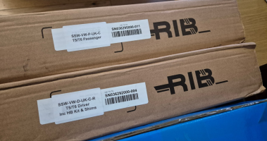

Heads Up on fitting these !! If you want to keep the full range of height and for/aft adjustment on the OEM seat, you will have to trim a fair chunk of the bottom edges on the lower side plastic trims (both sides of each chair) and a section deeper where the adjuster handle sits. You will be able to mark it on the up/down & for/aft positions to see how much to take off.
Is this not the same for all non-OEM swivel bases, or are there options that don’t require trimming?
Personally, I’ve never trimmed mine, as I keep the seat height raised using the built-in height adjuster. This provides enough clearance for normal swivel operation and is also the most comfortable position for my height. I’m using Sportscraft swivels.
At 6ft tall I have always had my seat on its lowest setting, so adding the RIB swivel with the packers to get over the handbrake added 43mm. I can just about live with this extra 43mm if the seat can still adjust all the way back down, which it would not do without trimming. Still feel like my head position is a bit near the roof but I will get used to it i suppose. The new bonus is that my other half does not need to make any height adjustment when she drives as the extra 43mm was just about where she would set in anyhow.

had a quick chat with the installer and showed him the solar panel manual, as suspected his answer was:
"the roof ridges are the same as on your van roof, I find these instructions strange really as we have always bonded the solar to the roof without filling them in (never had any issues) we have them on all our hire vans like this and all other customers too, if you have any air gap between roof and solar panel it can prevent over heating and improve efficiency"
Thats fine and i respect his experience and knowledge. however, my own experience tells me that this is not the case and that the air gaps cause differential thermal expansion which causes the bus bars to crack and the panel fails. . . basically the suck down high ridge bit doesn't move as much as the lower air gap bit with the hot/cold day/night thermal cycles.
this is also backed up with the install manual telling you to FILL THE GAPS. - so you have a smooth even surface to bond too.
anyway. . . no issues, I've asked him to fill that gaps with (something that im looking for now) when he sticks the panel down, so that the mounting will be even and the low ridges will be filled. - which he is fine with.

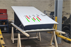

so just had a measure up.
looks like the high/low gaps are:
7-6-5-6-7mm across the roof. with 5mm being the smallest in the centre line section.
so im thinking i need to get a 5mm spacer, to be cut into strips to fill that gaps.

and to add balance. . . .
@Dilbert shows the PV LOGIC install guide that's states. . .
on a ribbed roof, use the same method, double glue, but leave the rib base open !!

i have loads, and dont have issues with them. . these ones were stuck on the shed for years with no problems. .
and these ones i have hanging in the garden, no probs.
