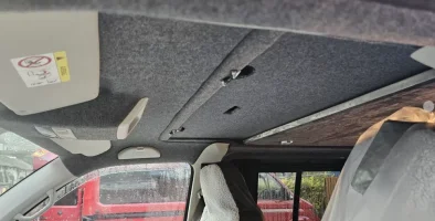

CAB ROOF - Carpeted to match the Poptop, But those plastics :sick: !!!
we had this:
Now, we have this, . . .
then watched this video about trimming. . .
and see he used this gear to colour code the beige plastics to black.
which will match better with the graphite grey plastics
so a quick google, get me here:
so all ordered.
and the plan is to spray the Beige bits Black.,
watch this space . . . . . . . .
we had this:

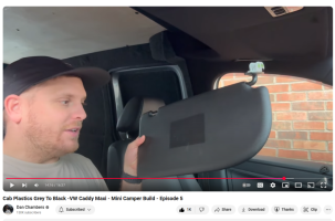

so all ordered.
off the back of this. . .
just watched this guys other video on the caddy build. .
and this time he uses DYE !!!
already ordered.
but now what to use? - the paint or the dye?

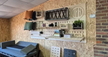

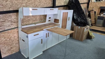

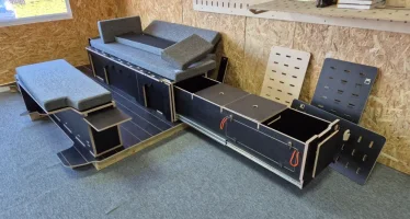

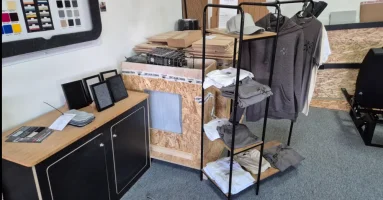

but wanted to see it in real life.
VF are open mon-fri . . . but with work busy had no way to get up to them.. .
but they suggest that we take a trip to SEASIDE CAMPERS in Hastings, as they have some kit on show.
we took a trip down there yesterday and had a chat with DAN, top bloke, and run through so examples.
1742738691116.png1742738704580.png1742738715220.png1742738726630.png1742738746658.png

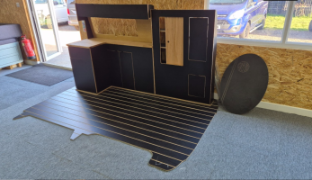

we managed to get to see the VF dark grey and the OAK worktop.
and also changed direction of the VF OAK floor.

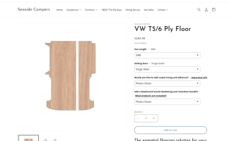

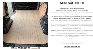

we are now going for a 3peice floor. . . .
1 - 9mm Batton board - bonded in to fill the low bits on the floor ( we dont want screws !!!)and pre-cut for a T6.
2 - 9/12mm PLY 2peice subfloor, and pre-cut for a T6.
3 - 2mm ALTRO SAFTEY Flooring - in a farmhouse oak effect, and pre-cut for a T6.
Dan had this all sorted out and orderd for delivery direct to us !
im fairly sure its drop shipped from HARRISONS , , , ?
for reference, we was going to go with the OAK floor from VF. . .
the next bit is the K2 kitchen. . .
we can order from either, and collect from either . . . . but with some trips booked in for April, timing as a problem.

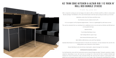

VanFurnature:
K2 Trim Edge Kitchen & Altair Rib 112 Rock N' Roll Bed Bundle (Fixed)
Color: Dark Grey
Oak Veneered Window Panel: Yes Window Panel +£130
Solid Oak Folding Table & Leg kit: No Table
Front & Back Bed Boards: Drawer Bed Board +£280
£3610
