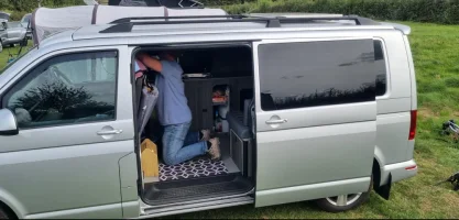

8D21E19E-76F2-4BDA-9FD6-FC59F93EF7BE.jpegYou sure you don’t need a poptop rich?:rofl:

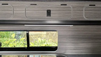

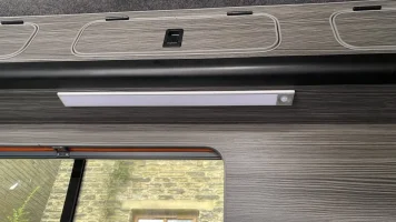

View attachment 173153I know you love battery stuff.
We have one of these which we use over the sink/hob.
It’s plenty bright enough and you can charge it up whilst driving along.
It’s also magnetic so I stick it on the outside of the van as an exterior light.
I’m just about to buy another one.
See what you think at the weekend.
Hi @Bigsidavies can you turn this light on and off manuallly?
John.
John.
Yes John. It has three positions. On/Off/Auto
Auto is great if you are sat outside the van in an evening as it turns on the moment you step inside and turns itself off quite quickly after motion has stopped.
We leave it on auto when we go out so there’s a light as soon as you open the door.
Get a couple of hours from one charge.
It lasted the full 3 nights at Sibbertoft last weekend.
I’ll post a pic up of it in the van shortly so you get an idea of size.

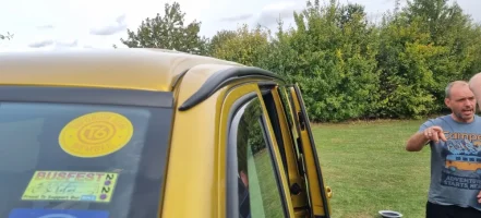

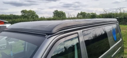

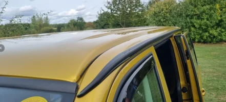

Were back from summer autumn camp 2022. . .
and had a chance to look around some of the awesome vans about. . .
looking around here are some things we decided we liked. . .
chatting about options @VanDamMan pointed out that a Kombi would have more options from Factory than a standard panel van. . .
this is worth noting as extras that a kombi may have are nice and prob` not worth the cost retrofitting on a PV after the fact.
we are still looking at a PV or Kombi with a OVANO or SLIDPOD box at the rear. . . . . to start with,
but realised that a kitchen conversion with 3/4 width bed is usable . . . . as in we could both fit.
but for now a day van is a better option to start out with. . .

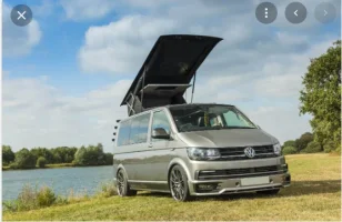

we loved the look of the HiLo pop-top roof. . .
as when down its almost invisible. . .
but noted that i take up space below the roof line inside, so internal chairs etc need to be carefully considered. . .
this would be my second choice from external looks , , , , (Vanmax. - but not available in LWB :confused: )

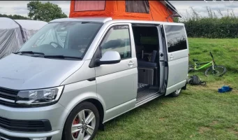

on the poptop front we noticed that we wanted a BI - FOLD bed board. . .
and the PANARAMIC CANVAS . . .

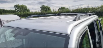

we decided we liked the idea of the REMO RAIL, and would prop go both sides . . .
one of the added benefits was that apparently the WIND OUT AWNING - that i wasn't a fan off can be fixed to this rail. . .
meaning it can be fitted and removed as needed - that makes things workable for me. . . so like the idea of that system . . (the removable option)
on the seating front, we liked the twin captains rotating front chairs . .
we also liked the TABLE that folds into the side door that @czmate1999 has. . .
we liked the WINDOW SHADES , that are necessary . .
other things mentioned . . . .
onboard water and gas would not be required to start with,
tow bar for future trailer is a worthy addition.

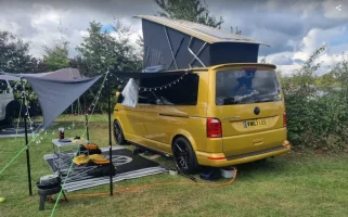

a side wind out awning, or side sail is a good way to start things off. . . ( for the meduim weekend setup)
a AIR SIDE AWNING is the way to go for the LONG WEEKEND / WEEK setup. . . ( but a TC version is big and bulky + Heavy )
