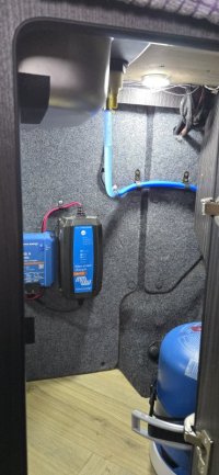

I recently fitted new kitchen and electrics in the van. I kept the original leisure battery (120ah) and replaced all chargers for victron ones (victron xs 50a dc dc and victron ip65 charger for when on EHU) .

So that means you only really have 60ah of usable battery. I'd personally upgrade to lithium before adding in solar. Most bang for your buck in terms of upgrade.
Okay, next question.....cables. am I going to have to upgrade the cables for lithium? I bought the Van with 16mm cables in for the split load but in order to change them, it's practically a rip out job again
Not my area here. You will need @Dellmassive (or someone else clever) to answer that. I just straight swapped my AGM to lithium without issue. I mean I'll probably find the van burnt to the ground at some point but there we go. 16mm is right sizing for a split charge. So as long as your are fully fused you should be good to go.
16mm is good for SB to lithium LB
You will need to use a DC-DC charger instead of the split charge relay.
I don't have a split charge relay (from what I know)....or at least haven't found one yet! From what I can see, it goes direct from starter battery to the victron dc dc charger. When i bought the Van, it had a ctek dc250se b2b charger which I removed.
You should manage to swap the AGM for lithium if you already have a victron DC-DC charger.
