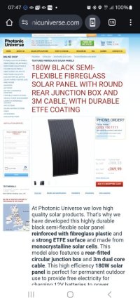

Any idea on the make on the panel mate? @Dellmassive

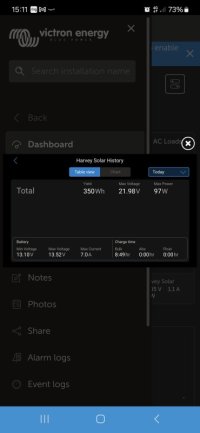

I rarely use EHU and solar is an absolute must for me.
A fridge running all day will use 30Ah of battery capacity and if you stay anywhere without EHU for more than a couple of days you'll need to replace that charge somehow. Obviously you could start and run the engine for an hour but that's noisy and not great for the van.
Mine (along with the LB and Ablemail) also keeps the starter battery topped, meaning I can leave the van sat for weeks at a time and not worry about it. And in the summer months I can leave the fridge on 24/7 and have access to cold drinks whenever I want!

@Dellmassive, how much space under the pop top do you estimate is needed for the cable from the rear junction box?
that depend on the pop-top.
mine has around 20mm void space, but the roof tub is around 15mm thick.
you will need to drill your roof tub, to see how thick it it.
then use a cable tie in the hole to see what space is available under the tub.
