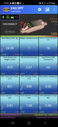

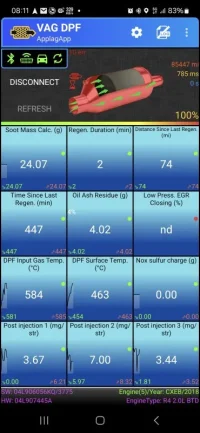

Loving the Carista Evo dongle and the VAG DPF app.
You can leave the new Caristar Evo dongle connected all the time, so it's super easy just to jump on the VAG DPF app when it starts to regen with the engine rev slightly increased.
The van Seems to be doing a Regen every 80odd miles.... And takes around 30mins

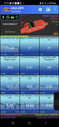

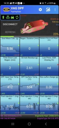

Here is the midpoint and the endpoint, started at 1350hrs and ended at 14 30hrs
Screenshot_20250220_141428_VAG DPF.jpgScreenshot_20250220_143057_VAG DPF.jpg

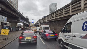

And this is my daily commute....

As @mmi said it stops at 6mg even though the percent bar shows 24%.
. And 100% shows around 25 mg. (Calculated)
Reactions: mmi

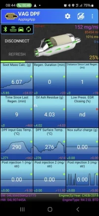

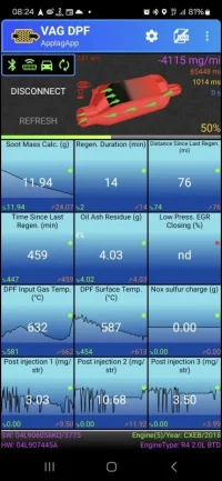

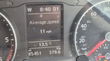

Here's another data set....
And yep.... That's 11mph average speed.
Welcome to London.
Screenshot_20250320_081133_VAG DPF.jpgScreenshot_20250320_082403_VAG DPF.jpgScreenshot_20250320_084411_VAG DPF.jpg20250320_083939.jpg
