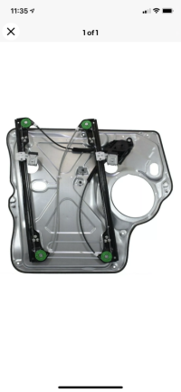

If you’ve got the door card off then can you not just take the window motor off the door thus disconnecting it from the window regulator. Not seen the T6, but it should just be a splined wheel on the back of the motor that rotates which in turn spins a wheel with cable on it.
You can then use the switch to see if the motor rotates both ways.
If it does then my guess is the regulator.
Just had exactly the same on my A4 and the cable on the regulator snapped and wound itself back around the regulator spool the wrong way so it would go up but not down.
This pic shows how the reg looks on the back of the inner door cover. The black bit top right is the spool mechanism that the motor attaches too.5F4D3B56-9739-4613-8106-F02C03431B1A.png

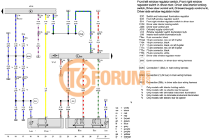

If you were a VIP ;) you could have saved yourself time and looked at the wiring diagram.
The switch uses resisters, also you can't swap the modules over as the coding is different for each door.
Wow thanks! Great all of these diags were available on the forum. Looks like a single diode and resistors. Been pricing module/motor as per your advice but I thought I might stick in a less expensive switch first to see if it might cure it.
With this diagram and wire colours, I should be able to try & meter the corresponding pins on switch module.
Just metered the switches. Get a reading of about 1KΩ between chassis and red/w wire. When operating up and down driver switch. Same on green/w wire.
Like you said previously Loz, maybe not the switch.
