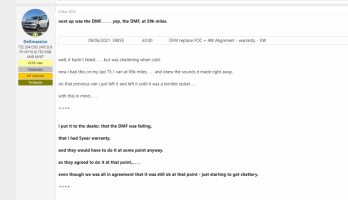

Just had to have my flywheel replaced on VWT6 with only 31,000 miles on clock..it’s under warranty but very surprised it’s gone so soon..was expecting 80,000 miles
Dont be surprised I had mine changed at 22,000 they're rubbish , the clutch was fine but obviously changed it as a matter of course

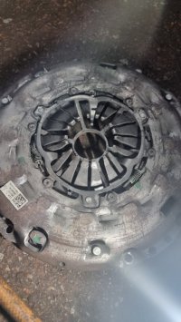

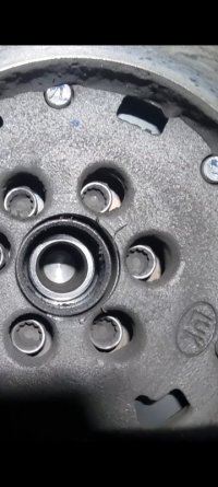

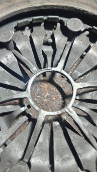

Changing one today at work. Not a bad job to change but this one done only 33k. Friction plate is 50% the smf has proper gone. 1000011404.jpg
I'll fish it out of the scrap tomorrow. I have a video of the DMF play. Yeah it's LUK clutch, we replaced with LUK.
Genuine DMF was £200 more for the same part but without the VW logo painted on it.Also notice the crack around the centre.

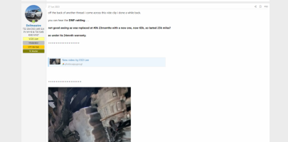

Here's a link to video I just uoloaded of the play in DMF
On my Euro 5 DSG 2016 T6 the DMF went at 11k miles (yes eleven thousand) and 2 years 10 months old.
It was done under warranty.
I've had mine done twice, . .
about 40k and 60k - both under warranty.
