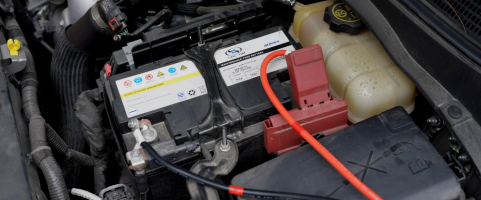

1. Picture of a consumer unit MCB used as a 12v breaker - a free floating DIN rail mounted breaker in a high current cable with no other protection is a bit... squirmy
2. Very clear picture of how NOT to wire to any modern vehicle and instead give it endless starter charging issues by wiring the wrong side of the battery shunt - with a side order of unsupported cables that hold up the terminal protection caps
