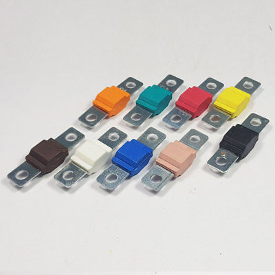

Only just fitted mine yesterday... A quick test, showed it was charging at the full 800w even on tick over, sitting on the drive. I would normally only charge when driving though, this will obviously help to keep the alternator cooler. The inline fuse EcoFlow supply is 125amp this is a bit high for the cables I'm led to believe so I'm changing mine to 100amp fuse.

Alternator Charger: EcoFlow direct online
100amp Fuse: eBay
100amp Fuse: eBay
