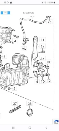

OK . Went to van centre manchester. Egr pipe, 2 gaskets. And 4 bolts. Just in case. From experience.
£153.00.
Bolts are 2 x m10 spline and 2 x m8 spline..
Does anyone have the part numbers for these 4 bolts please? I've got the numbers for the gaskets and pipe, but can't find the bolt part numbers. Dont want to risk doing the job and realising the old bolts are knackered and VW won't give me the part numbers unless I buy from them, but at their new inflated prices, I cant afford it!

Took a little longer than 15mins but wasn’t too bad. 1/4” ratchet proved essential as the lower bolt was a fiddle. Part numbers for future ref
