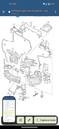

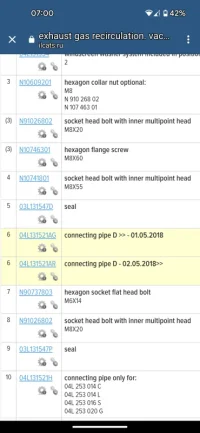

Sorry to hijack this post. My front EGR pipe is looking similar.
Can anyone confirm the latest part number for the front Flexi pipe?
Are the two part numbers here relating to year of vehicle manufacture or is one simply the latest version of the part?
And could I fit the latest part to a 17 plate van?
