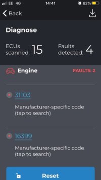

I have bought a Carista & have the following codes:
Should reset them & wait till annual service in Feb to get them sorted...
Basic OBD2:
P2006 (Pending) - Intake Manifold Runner Control Stuck Closed Bank 1
P20EE (Confirmed) - SCR NOx Catalyst Efficiency Below Threshold Bank 1
Engine:
31103
16399
Basic OBD2:
Engine:
31103
16399
16399=P2006
31103=P20EE

The ECU software seems to be up to date - so no easy fix there.
Resetting them leaves nothing to work at the service. On the other hand if the faults won't resurface there would be nothing to repair.
I'm inclined to think the air intake manifold needs attention.
Meanwhile the P20EE is just an indication of raised exhaust NOx level - as such not an indication of any specific component failure. Quite possibly here just a consequence of the above.

I'm afraid we don't have enough information at the moment. E.g. Carista's fault log lacks all the details of the faults - time/mileage stamps, fault frequency, etc. thus we actually don't know if the pending (P2006) fault was just a single hiccup a long time ago, or if it's a fresh, frequent one.
Have you got flashing coil warning light on dash? If so - a proper diagnosis is definitely needed.
The P2006 issue was seen also here:
Also
EDIT:
The location of the manifold flap actuator:
A couple of more threads
Possibly related and/or perhaps some useful information:
The P2206 issue was seen also here:
Also
I have had the flashing coil light a couple of times but if I switch off ignition & restart it goes out.
Basic OBD2:
Engine:
31103
View attachment 176662View attachment 176661
16399
The intake manifold flap is controlled by an actuator which is vacuum operated, check the small hose that feeds it, check the actuator moves as the flap can carbon up and if that is the case will need a replacement manifold.

An example from "Car Scanner" app - by taking advantage of Carista dongle.

fault codes:
P20EE00
P200600
P200400
P012100
