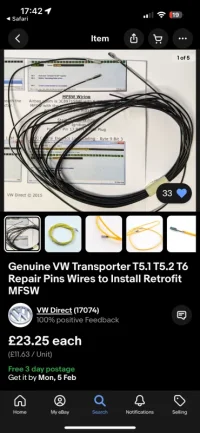

Repair wire kit - retrofit for MFSW​

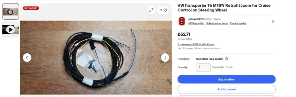

Can you elaborate on the "Repair wire kit - retrofit for MFSW" please.
I've found the polo wheel and airbag and have high hopes of doing this now.
Reactions: CJW
Hi Tanstaff. This is what I bought:
