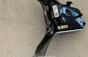

Could you please, if someone is able to take a picture of the PCB board of the left controls from the back? Standard controls not touch. A close-up picture, with as much detail as possible. I have the controls, but someone before me unsoldered the chip and a few other components, so I don't know the orientation and location of those components, also couple SMD resistors are missing and need to be able to read the values from pictures.
Sorry I've never taken my buttons off.
Have you looked online for photos of the buttons? There are lots of them on eBay etc but maybe not good enough photos?
