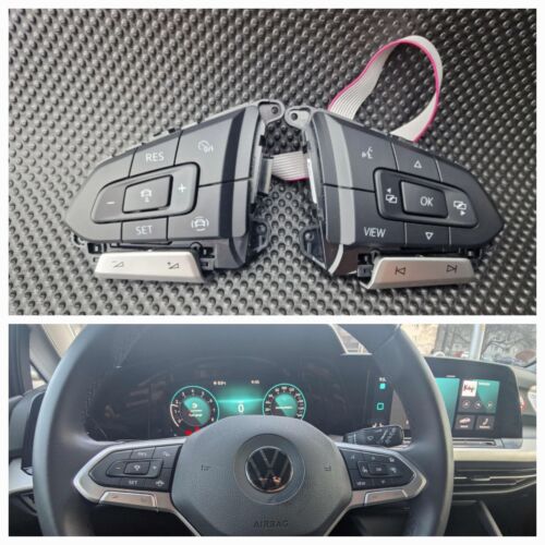

Hey Nemesis,
can you tell if these buttons have the connection for the DSG paddles?
I fitted my wheel quite soon into ownership and without many miles on the clock so if im honest i not 100% what menu that button took me into before i swapped the wheel, when originally asked i just thought yes the button works and takes me into a/the menu, retrospectively that was a bit of a throwaway comment and i guess it behaves the same as everyone elses like @MK2Golf24v button does
Apologies if i have mislead anyone with this :(
