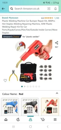

As part of the diesel heater install I have noticed a few damaged panels, I have decided to repair them, I have done the first one today as it was just the heatshield that had come away, I just used some rivets and washers to fix it, I have another panel (not pictured) to fix but it is plastic so I am waiting for one of those hot staple guns to arrive from Amazon.
Well the plastic welding staple gun arrived this morning, it worked great.
Best £22.49 spent in ages.

A bit of seam sealer to fill in the holes and done, a really strong repair and less than the £100+ for a new one that only myself and an MOT tester will ever see.
