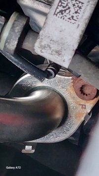

Still trying to cove all bases before going down the route of getting the EGR replaced. I am getting the code P0400. I noticed today that the cable that goes to the sensor that is on the top of the EGR valve adjacent to the manifold where the 'long front pipe' leaves the EGR is broken. I am imagingin it is jus tthe protective outer, or is it likley that wires could be damaged too?
Is it possible to identify the name of that sensor and advise if its function can be tested wiht OBDeleven? Cold a dodgy connection - and therefor e temperamental signal from that sensor cause the P0400 code?
It’s just a heat proof sleeve, but bending the wires like that won’t be good for longevity. Push the sleeving down onto the sensor body.
I’ve seen similar in various places on my van, WM OEM wiring is pretty shit IMO when I compare it with my 22 year old Audi.
It wreaks of CHEAP.
Thanks DXX. Will try and reattach them. How can I tell if the wires are already damaged? Could my P0400 code be caused by dodgy signal from wiring or sensor?
Unlikely the wires are damaged, more likely the EGR cooler is blocked with soot. What’s the mileage since new or the last EGR renewal?
EDIT; if it‘s the original EGR with 155K miles you’ve got your moneys worth, I’d say replace it.
