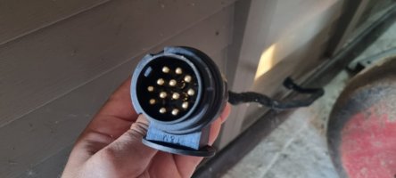

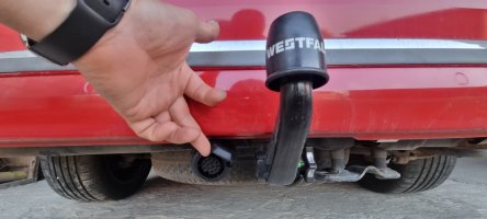

Definitely possible with OEM T6 lowline camera via 13 pin socket.
Highline camera would be much more challenging thou.

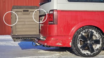

I am struggling for a space on a long journeys so every [cm³] of storage space outside the cab is more than welcome.

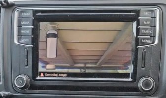

Roof box was not enough so I had to add tow bar box but it blocks the view from my Reversing Camera.
Tailgate camera looks like this.

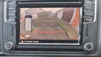

Once I implemented my solution (described in my previous post) I am getting the video from the tow bar box camera automatically (when reversing gear is engaged ):D.
It is worth to mention that Dynamic Guidelines on the HIGH RVC setup are being deactivated automatically once anything is plugged into the trailer socket.
Full demo video below.

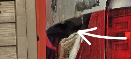

A great project and outcome. A question: where did you you mount/position the relay? Within the tailgate, close to the tailgate camera or elsewhere?
Thanks for the quick reply. That helps heaps. So, sounds like a similar location as the connection for the OEM trailer connection (yes, confirmed by your pic). I have a fully lined campervan, but I have made a hinged latch to get access to the trailer connection when I fitted the OEM VW trailer. I have OEM lowline camera in the tailgate, so will investigate best location for the relay as a compromise for each camera. Your outcome is what I would like to achieve, so am now hunting around for a 2nd OEM camera. Thanks.
