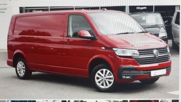

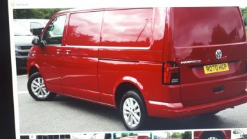

CTView attachment 125589View attachment 125590View attachment 125591
Sounds good. I don’t think your speedo will be out though, as I think 235/55/17 is a factory size?
