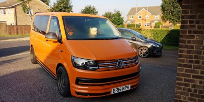

The sun starts to set, and I head outside to take a look and bask in that smug feeling, which is rapidly eroded by the clear RAC writing that’s now showing:
after a very mild panic I decide that I’m sure a bit of autonomy paint restorer will do the job and spend the evening buffing. Easy least with a Ryobi battery powered buffer and before you know it it’s just a REALLY ORANGE van.
Difficulty level = 0 (easy peasy lemon squeezy)
Time taken = 2 hours
Made me feel = quite smug.
