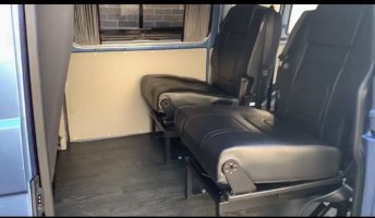

Hi everyone,
I had my seats fitted by VW-T in Henfield, West Sussex.
I couldn’t buy the fitting kit. And in some ways J am glad I didn’t attempt it myself.
The seats are very heavy. And fitting them structurally needs to be done professionally.
VW-T made my brackets to fit where I wanted the seats.
You can’t actually see them from underneath as the plastic covers under the van hide the fixings being visible.
And of course it wasn’t just a case of being able to get the seats fitted. I had to also have an CNC cut new structural wooden floor fitted prior to the seat installation. Fortunately this was all done by VW-T
From memory the cost of this was £1200 back in early 2020.
But I am pleased with the results.
If you are using these Neptune seats as I am, the front seats will form part of the bed. To do this you need foam wedges to go on the front seats to level them out. I have a spare set FOC if anyone wants them?
