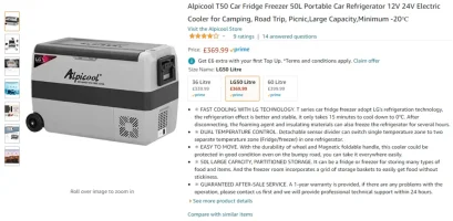

Thanks, what about this one for similar price: https://www.amazon.co.uk/dp/B08J3RW85M/ref=cm_sw_r_cp_awdb_imm_W1BK6KVXZ5PZ04YWXGA6?psc=1

That one is epic . . . . . . . !
but also mains powered . . . so you need a 240v supply.

The PSU is mains but not the input, will look again.. Yeah, 12V 5A power
