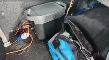

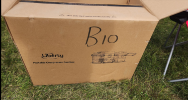

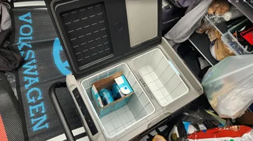

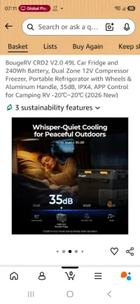

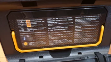

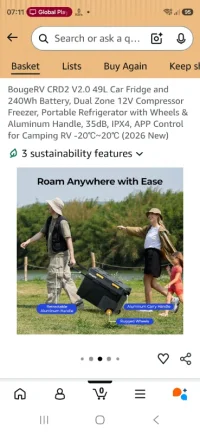

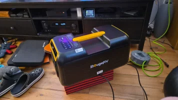

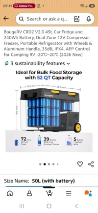

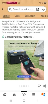

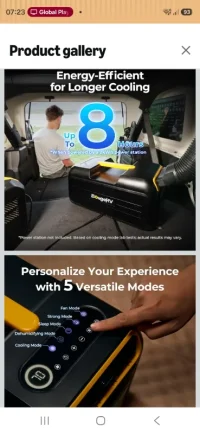

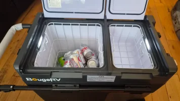

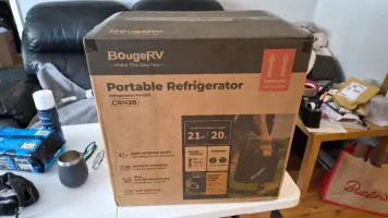

our latest fridge has just had an upgrade. . .
me and
@garyp1969 managed to grab two of these fridges at Camperjam this year for £250.
12v + 240v
dual zone,
-20 to +10
BT App,
additional battery available
Solar input - when used with battery.
we got them from Mel at the DC Leisure stand. . . we see them at Busfest as well. (awesome shop and people BTW)
DC Leisure – Your ultimate outdoor camper store for camping, campervan, and leisure essentials in Runcorn, Cheshire. Free shipping on orders over £150.
dcleisurestore.co.uk
View attachment 259014View attachment 259015View attachment 259016

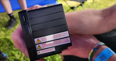

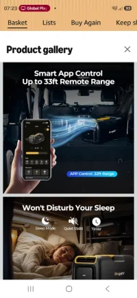

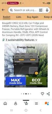

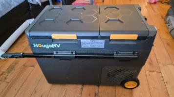

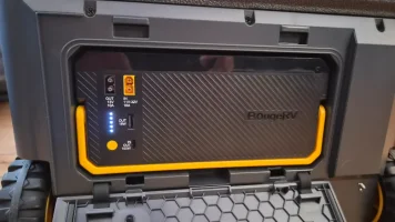

so whats the upgrade?
well myself and
@garyp1969 are currently on the lookout for the battery that fits these units - that's a reasonable price.
in the meantime i managed to buy
@Swamper_Jez spare battery - well he had two originally, and agreed to sell me one of them - Thanks Jez

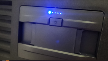

the battery fits inplace of the blank cover next to the power in,
View attachment 259017View attachment 259018

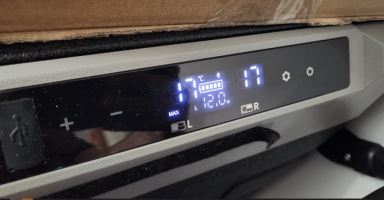

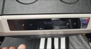

when the battery is powered on, you have a status light and 4x battery level LEDS,
the idea is to cool the fridge down on mains. . . then flip over to the battery.
Jaz has reported that the fridge will run for a good 12hours from the battery. . (normal specs, pre-chilled fridge, 4degC normal use case etc etc)
plus, now we have the battery. . . . we can connect a solar panel for the jack at the bottom,
that will help run the fridge and charge the battery. . . . Nice.
oh and when the fridge is on wired power, ie 240v it charges the battery as well, (not tested 12v yet, but assumed the same)
you can also turn the battery ON/OFF completely so the fridge ignores it.

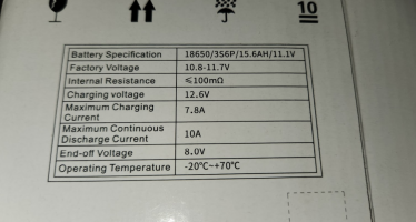

battery INFO:
11.1v with 15.6Ah
18650 batts in 3s6p configuration.
10.8 - 11.7v usable range.
chargeing voltage - 12.6v
charge current max - 7.8A
discharge max - 10A
