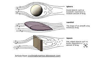

As @DXX says thin edge trailing. If you think of a water droplet falling, then it doesn't stay spherical. But it falls with a rounded end at the bottom and a pointy end at the top. This is the most aerodynamical shape.

Thule aero bars go round end forwards, like a aeroplane wing. I don't see why these should be different.

Thin edge leading, round edge trailing. Aircraft wings are designed for higher air pressure underneath in order to achieve lift off, that’s why they are round edge leading. The very opposite is required for a road vehicle which requires the higher air pressure above in order to help keep the vehicle on the road.
Bernoulli’s Principle explains this.

Its not rounded front/back or pointed back/front that of a wing that creates lift. Its the distance that the airflow has to take. The air over the top of a wing has further to flow than the air that travels below. The faster moving air creates lower air pressure than the slower moving air below, producing an upwards force on the wings. The shape of the roof bars are not affected by Bernoulli's principle at all.
Just saying...
Edit and for what its worth F1 cars 'wings' are still rounded end at the front and pointy end at the back. Just they are like aircraft wings upside down.
