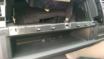

This the space with the glove box out
Got any more pics like that @carlg with the glovebox out you should be able to see the USB interface we were talking about ?

Yes both sides need cutting back ,across the bottom needs cutting and in the photo a few post up at the top there are 2 square blocks that need cutting off .
It's the bottom that's the problem it will need some modification ,you might need some felt or I looked at a flocking kit to make it look good ,I think when glove box is closed you don't see it .
If you look at your new glove box you will see how thick the lid is and you have to get it to fit flush ..The new vents are slightly thicker than old so it will line up better
from what I can see looks like the glovebox sits a lot further in
Yes it does ,if you look at the photo higher up ,between the 2 square blocks there are som clips the glove box will clip in those
