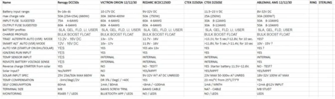

well . . . . . . . . .
all-in-one:
The Renogy DC-DC / MPPT is a great all-in-one option. (dc-dc & mppt & solar starter charge & auto VSR)
The Ctek D250se is also very popular. (dc-dc & mppt & solar starter charge & auto VSR)
Redarc is nice and small (dc-dc & mppt & auto VSR)
Separates:
Victron ecosystem is fantastic with great monitoring - (dc-dc & mppt & solar starter charge & auto VSR)
any of the above will suit you. (look for a charge rate between 20-50A)
get a couple AGM`s (100ah size or above each)
get 100-200w+ solar (mobile or installed, u can have 2x100w in parallel for low VOC devices like the Ctek)
make sure its all installed and fused correctly
My current personal favourite kit is the Victron, its robust, and just works! plus the monitoring side is way more advanced than any1 atm.
have a look over the kit list for more ideas.

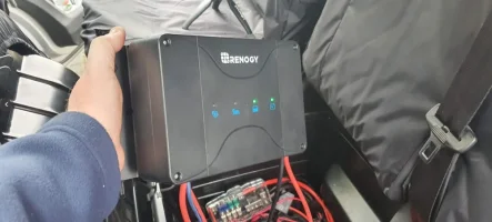

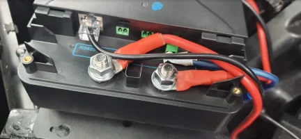

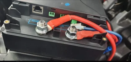

The Renogy DCC50S is a very good DC-DC / MPPT charger. (now 30A or 50A)
a fair size box, but nice cable management covers and built in temp + Lithium charge limiting when cold. (or AGM boost)
I've got one running in the van right now. (50A version)

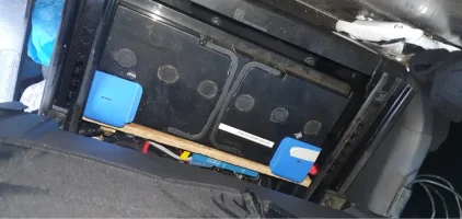

here is a BM2 charge readout over a few days (for that AUX battery under the seat, AGM atm)

FYI here is a look at the 30A version.

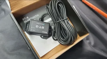

This is the BT-2 Bluetooth adapter that works with an APP on your smart device. (phone in my case)
this is what you get . . .
right ok . . . so lets connect it . . .

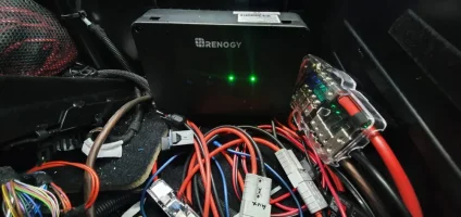

Nice cable managed covers on the DC50 . . . the BT-2 plugs in the RS485 port.
here . . . .
size wise its ver small, about the size of a box of matches . .
The green light comes on when its connected,
the blue light shows comms when its talking to the phone and the APP.
this is the booklet
simple enough right . . . . =]

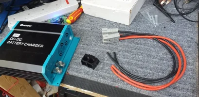

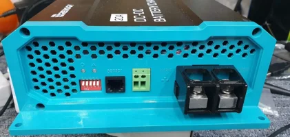

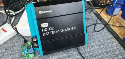

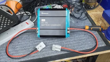

I've had this unit since summer 2020 . . . but with all the Solar stuff doing the rounds i forgot about it.
i think its time to dig it out . . .
Renogy 20A DC-DC charger. - RNG - DCC1212-20-EU
Description:
The DCC12 Series battery chargers are the most effective way to charge your auxiliary or house batteries from the alternator/starter battery. Compatible with a multitude of alternator types, the DCC12 offers correct charging for AGM, Flooded, Gel, and even Lithium deep cycle batteries!
Featuring a 3-stage battery charger and multiple electronic protections, owners can feel confident that their batteries are being charged optimally and automatically. For added safety to personnel, the DCC12 isolates the input from the output preventing incorrect voltage transmission. Easily install the compact yet sturdy DC1212 on RV’s, commercial vehicles, boats, yachts and many more applications!
  • Multi-Chemistry Battery Types: AGM, Flooded, Gel, and Lithium
  • Smart Protection Features: Over-voltage safety, Overheat protection, and Reverse polarity protection

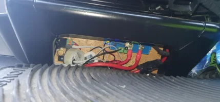

this is my one . . . . . out the box and rearing to go.
connection wise we have main power out, with sensor input, DIP switch setting and status LEDs . .

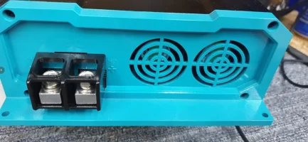

the terminals are nice and chunky . . .
the other side we have the input and some fans . . .

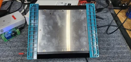

not much to see in the base . . .
the black covers clip off to get access to the 6mm screw bolts for the main cables.

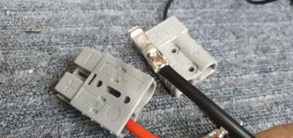

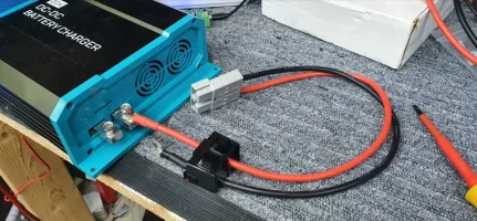

As you know i use 50A Anderson connectors in the van as quick disconnects so that i can swap out chargers as and when i need to for testing and playing about . . .
this is a 20A unit, so 50A Anderson connectors will be fine . . .

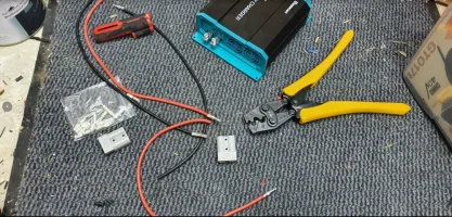

So lets make some cables up.
10AWG Silicone high temp flexible cable is double crimped onto the pin ends . . .
and snapped into place inside the housing . . .

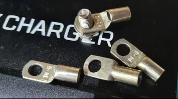

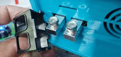

in and out side made up we move the units connections. . . . . a 6mm screw bolt for this unit.

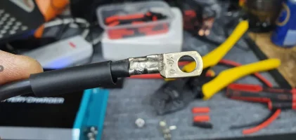

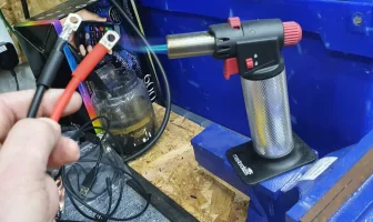

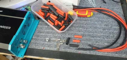

i had a rummage and found these 6mm luggs that look suitable. . . .
cut some heatshrink . . .
double crimp on . . .
and apply heat . . .
take the cover off . . .
slide cables through . . .
take out bolts . . .
screw down tight . . .
replace cap . . .
this is what we end up with . . .
