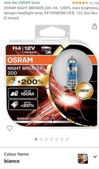

has anyone tried this upgrade bulb kit?
It doesn't matter what bulbs you put in the H4 headlights, you'll never get good light output, they're just rubbish. I tried several extra bright bulbs, the improvement was tiny.
I kicked this around for a bit, finally I went for these £21.99 from Amazon, not enough money to be terribly upset if they were nothing special, I have to say I am pleasantly surprised, it’s a tough one as 200% of next to nothing is still not much, but for only 21:99 it’s ok. I have spent more and been less impressed, sure they are not LED’s they are still rubbish lights, but not as bad as they used to be.
