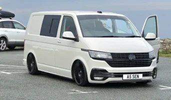

Its not for the weak! Haha Mines down about 160mm I reckon give or take. Subframe catches/scrapes on speed bumps, as does the front jacking points and exhaust. I've almost beached it a few times but wouldn't have it any other way!
SoLows all the way down, machined top mounts and hub mod. Got adjuster deletes to go on the rear as soon as the weather turns a bit nicer! Sat on 20"s

Just reading about the hub mod now. How much extra drop do you reckon that gives? 20mm ish?
That's the kinda low I'm talking about! You didn't fvck around did you
How do the SoLows ride? Obviously these mods aren't for comfort haha
Any other bits done? Linger drop links I'm guessing?
Looks awesome dude

I had longer drop links, they started knocking and I couldn't be bothered to replace them so removed the whole anti roll bar.
Hub mod dives about 10-15mm iirc. Don't quote me on that though! Solows ride brilliantly even at this height! I wouldn't have anything else!

I am surprised that some of the comments are honestly pointing out the issues of extremely low vans , usually owners of very low vans simply say they ride like stock Ha ha , ( its NOT possible of course ) , at 160 mm lower there is no travel left in the suspension , drive shafts take a lot of stress , wheel alignment is nigh on impossible to get perfect and tyre wear is extreme . The roll centre of the vehicle is likely to be underground so all in all not the safest things to do. If the van is primarily a show van you can put up with these problems . If you drive it every day expect a certain amount of pain . .
There is a reason that TUV do not approve any lowering of more than 80 mm and even though UK doesn't recognise TUV , it still makes sense to be mindful of it .
Modifying top mounts is also an issue , we remove all these on vans we work on as the stress on the mount causes them to break up .
Its also important to realise that at 120 to 130 mm lower you can only adjust up 30 mm which means the van will still be very low even at max height .
We certainly would never lower a Transporter to anywhere near these height's and i am pretty sure any decent Transporter suspension company ( who value their third party insurance ) would hesitate to do it as well . the come backs and issues that will be experienced would put most off , there will be private individuals doing these mods and as they dont need to worry about third part risks and there public liability insurance they are happy to plod on .
I am the kill joy of the industry as everyone knows but glamourising super low vans isnt good for most owners who maybe dont realise what a mine field this is ,
