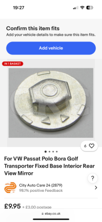

This is what is behind it, and that’s how the cover clips on. I removed mine to fit a rear view camera screen
1740425322726-png.276174

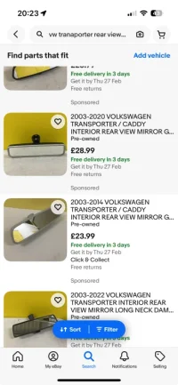

I don’t suppose you know of a mirror that fits please? I could do with a mirror to keep an eye on the little one. Bought a cheap Amazon one which fell off after a day!
(Tried removing this with no joy too! The cap comes off but it doesn’t help much). Thanks
It will be bonded to the screen and if removed will most likely leave a black circle where the glass has been etched to the best best would be to fit a mirror.
Any standard transporter or caddy mirror will fit

If you opt for a OEM mirror there is videos on you tube to show how they are fitted
https://www.google.com/search?q=fit...e=I've&vld=cid:63e2be9f,vid:nv2gdJM0SOY,st:35
Great thanks, I was looking on Amazon but struggling to find much. I’ll take a look!
