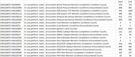

Those seem to be just counting how many times specific engine's self-diagnostic routines have been run.
E.g below counters for a healthy CXEB engine across a period of 3500 km's.
Obviously some of the routines do not exist on this engine.
