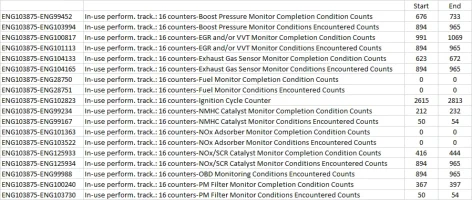

Loc. ENG103875-ENG99452 In-use Performance Tracking: 16 counters-Boost Pressure Monitor Completion Condition Counts counts 4006
Loc. ENG103875-ENG103994 In-use Performance Tracking: 16 counters-Boost Pressure Monitor Conditions Encountered Counts counts 3390
Loc. ENG103875-ENG102823 In-use Performance Tracking: 16 counters-Ignition Cycle Counter counts 6749
Loc. ENG103875-ENG99234 In-use Performance Tracking: 16 counters-NMHC Catalyst Monitor Completion Condition Counts counts 330
Loc. ENG103875-ENG99167 In-use Performance Tracking: 16 counters-NMHC Catalyst Monitor Conditions Encountered Counts counts 153
Loc. ENG103875-ENG101363 In-use Performance Tracking: 16 counters-NOx Adsorber Monitor Completion Condition Counts counts 0

Those seem to be just counting how many times specific engine's self-diagnostic routines have been run.
E.g below counters for a healthy CXEB engine across a period of 3500 km's.
Obviously some of the routines do not exist on this engine.
