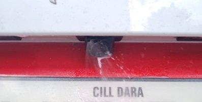

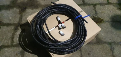

Some required components from EU.
My order arrived :cool:.
Now I need to figure out how to mount my washing nozzle jet to achieve something like that :cool:.
I hope there is enough room in the camera housing
7E0 980 561 A :whistle:.

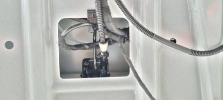

And I got it verified, on VAG OEM setup, the camera is washed simultaneously with the tailgate window :).
So no extra solenoid valve is going to be required :cry:.

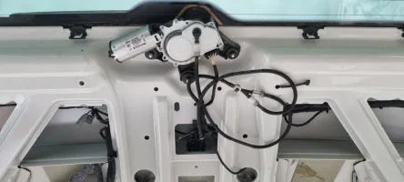

I have missed few settings :whistle:.
I must get them activated with no further delays!

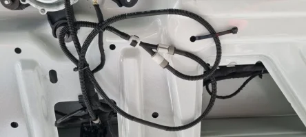

P.S. These cables appear to be tangled :D.

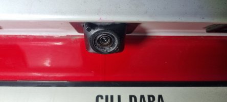

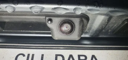

External comparison for exact nozzle location and positioning.
My OEM T6.
Other OEM VAG.
I think it is quite obvious that nozzle should be in the top LHS corner(BLUE DOT).
