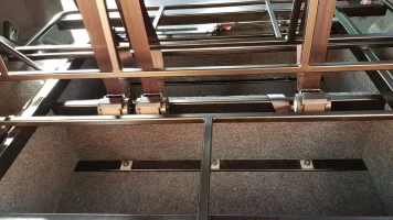

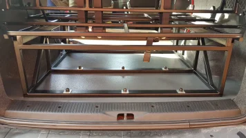

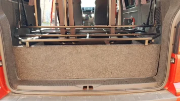

Built the storage under the rock & roll bed

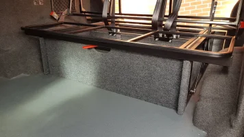

Carpet lined to match the walls, I've attached all the panels with strong magnets so that they can be removed if needed for access for longer items
Finished the front legs of the bed off in carpet so that they don't stand out
Cushions are trimmed to match the front seats and will be going on next week

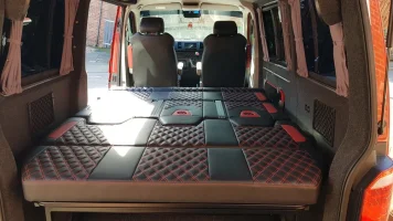

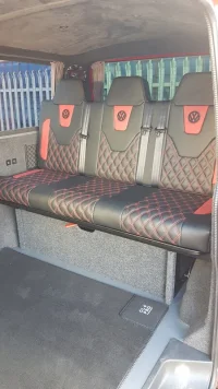

Seat cushions are finally on so we can now actually sit in the back of the van.....:cool:

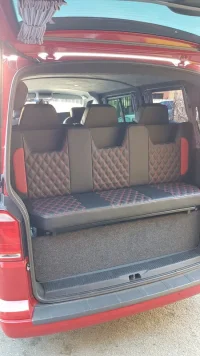

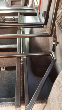

Have the same bed as yourself and going to make my own bed boards like yourself. I’m just wondering how you remove the front board with the legs in the way. Do you have to slightly move the bed forward ?

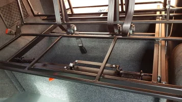

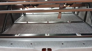

Depending on the RnR bed you fit, you can get plenty of stuff in under the seats. We've always used RIB beds and you can fold them as a bed, allowing full width/length load space (not height though obviously) and narrow enough stuff slides between the legs, giving full van length. Currently have a 3 seat 130cm wide RIB, which leaves 26cm free alongside the bed (wheel arch aside).
Doesn't look like the pic anymore, as added kitchen, bed boards etc.

No, the 26cm is the space to the side of the seat - full height space. My RIB is tight against the passenger side (they are designed to sit over the wheel arch). I DIYd a bench over rear drivers side arch from edge of the kitchen pod to the rear (26cm wide). It gives a full width bed for the head end half of the bed and space below it for 15 litre water tank and DIYd gas box at rear.
