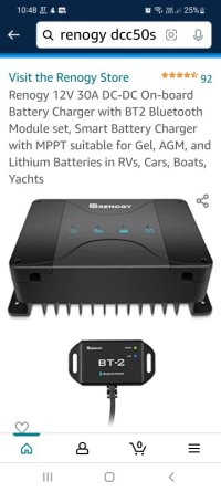

Swap it out for a Renogy Dc30s.
Fanless so silent.
Plus you can add solar to it at a later point.
