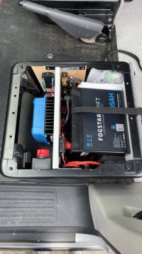

My build is progressing slowly - kombi as daily and two kids so edging towards the BIG STUFF. I’ve got 2 amps under the the single passenger seat and just about finished a battery/b2b charger build completed under the driver’s seat. I have a primary midi-fuse box alongside the battery but not the room I wanted for another blade fuse box for lights, fridge, etc. it got me thinking as to where to put it. It actually makes quite a bit of sense to put it behind an access panel on the n/s near the tailgate. Very easily accessible as opposed to being buried at the back of a cupboard. Cable runs from the fuse box to fridge would be a little longer, but no difference in heavy cable length (seat to back) if the seat installs were reversed. Ball-ache but maybe better.
Thoughts?
Any concerns over voltage drops?
