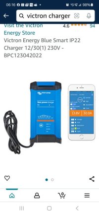

For your twin agms,
I would recommend
A 30A victron smart charger,
Example..
IP22. - 12/30/1
(12v 30A. 1x output)
Or the basic 15A version.
12/15/1
