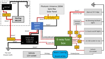

Hi all,. After having read and absorbed as much of the advice on here that I can understand, I think I'm finally ready to build my leisure electrics system.
I'd be grateful if someone could cast an eye over my schematic to check my homework. Some of this is stuff we inherited when we bought the van and some of it yet to be installed/bought.
Most question marks are have I got the cable sizes right and are the fuses correctly placed and rated?
The dotted line from the Victron 75/15 is me wondering if that is how the 'load out' feature is supposed to be used so that the MPPT can be a smart switch between the loads and the battery? At one point I was thinking 'load out' was only for items that could be used when the solar was generating sparks but now realise that is a ridiculous idea.
At one point were also considering a Renogy DCC 50 or 30 to replace the Sterling BB1230 and the MPPT but budget means that will all wait for if we move to LiFePo battery next year.
DCDC - Sterling BB 1230
MPPT - Victron smart 75/15
Solare panel - Photonic Universe 200W
LB - Probat FLA 110 Ah
loads - the usual, Fridge, USBs, Lights, 12v
Van goes in a couple of weeks to get pop top and solar panel installed.
Thanks for all the advice I've already read and thanks in advance for any further comments on this plan.
